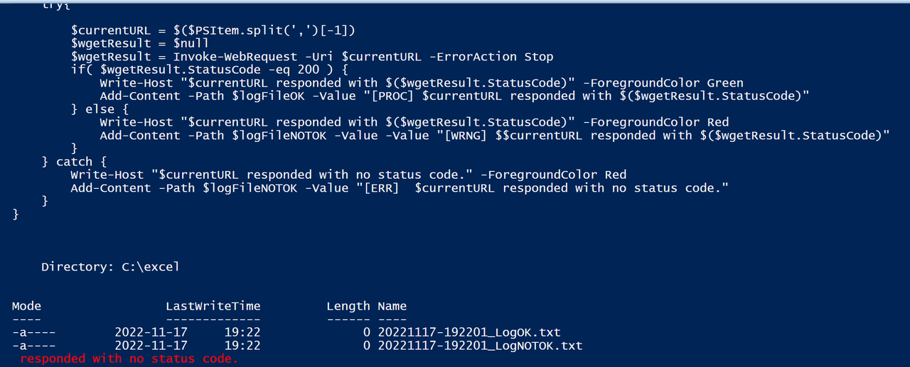

Skrivet av GreyWilk:
Nice! Inga problem!
Japp. En liten miss i koden. Lätt hänt ^^
Klistrar in _hela_ koden som den ska vara... hoppas jag xD
Nya koden skriver ut i console och i loggfil. Justera sökvägar efter behov
$tempArray = @() $csvdata = Import-Csv -Path C:\temp\zencity_testdata.csv -Delimiter ',' $groupedCSVdata = $csvdata | Group-Object -Property company,category $groupedCSVdata | ForEach-Object { $randomMax = $PSItem.Group.Count $getRandomIndex = Get-Random -Minimum 0 -Maximum ($randomMax-1) $tempArray += -join( $PSItem.group.company[$getRandomIndex] + ',' + $PSItem.group.category[$getRandomIndex] + ',' + $PSItem.group.type[$getRandomIndex] + ',' + $PSItem.group.url[$getRandomIndex] ) } $logFilePath = "c:\temp" $logFileOKName = "$(Get-Date -Format 'yyyyMMdd-HHmmss')_LogOK.txt" $logFileOK = "$logFilePath\$logFileOKName" $logFileNOTOKName = "$(Get-Date -Format 'yyyyMMdd-HHmmss')_LogNOTOK.txt" $logFileNOTOK = "$logFilePath\$logFileNOTOKName" if( -not $($logFileOK | Test-Path) ) { New-Item -Path $logFilePath -Name $logFileOKName -ItemType File } if( -not $($logFileNOTOK | Test-Path) ) { New-Item -Path $logFilePath -Name $logFileNOTOKName -ItemType File } $tempArray | ForEach-Object { try{ $currentURL = $($PSItem.split(',')[-1]) $wgetResult = $null $wgetResult = Invoke-WebRequest -Uri $currentURL -ErrorAction Stop if( $wgetResult.StatusCode -eq 200 ) { Write-Host "$currentURL responded with $($wgetResult.StatusCode)" -ForegroundColor Green Add-Content -Path $logFileOK -Value "[PROC] $currentURL responded with $($wgetResult.StatusCode)" } else { Write-Host "$currentURL responded with $($wgetResult.StatusCode)" -ForegroundColor Red Add-Content -Path $logFileNOTOK -Value -Value "[WRNG] $$currentURL responded with $($wgetResult.StatusCode)" } } catch { Write-Host "$currentURL responded with no status code." -ForegroundColor Red Add-Content -Path $logFileNOTOK -Value "[ERR] $currentURL responded with no status code." } }
Provade koden men den spottar ut två tomma filer, har ändrat source och logfile location men gissar att det är något annat som spökar!
Bifogar bild på error men som sagt, tidigare när jag får i consol och kan kopiera in själv funkar så spendera inte för mycket tid på mig

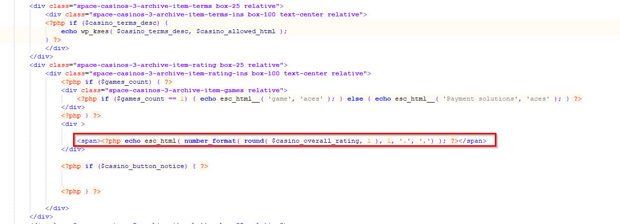

Skrivet av ShinyChrome:
Du har nästan koden färdig i och med det du skrev.
Något i stil med:
if ( $casino_overall_rating == 5.0 ) { echo '<img src="pic5.png">'; }
Problemet med den koden är att värdet förväntas vara exakt 1.0, 2.0, 3.0 etc, vilket skulle göra att inget visas om det är till exempel 4.3
Då kan det vara bättre att jobba med ranges, eller avrunda talet till heltal.
Tack och bock! Det där funkade alldeles utmärkt

Hjälp med PHP för att modifiera wordpress widget
Jag håller på och försöker att modifiera en Wordpress widget.
Tidigare har en funktion visat betyg och antal stjärnor.
Stjärnorna har jag lyckats få bort. Nu visas istället bara betyget som en siffra. Exempelvis "5.0".
Själva grundfunktionen vill jag ha kvar men som output vill jag istället ha en bild beroende på betyget.
Se nedan kod:
https://i.postimg.cc/bNYCqg7j/code.png
Jag är dessvärre svag på programmering men jag vill att logiken ska se ut så här:
Supertacksam om någon PHP-ninja kunde hjälpa mig med kodning
